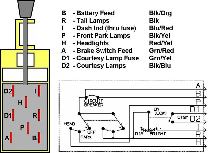

To continue the thread of headlight issues, I have a photo attached of the plug which attached to the light switch on a 65 Mustang.
The three circles areas are confirmed as having power to them but the rest did not light up.
For context, neither my low beam or high beam work at the moment but park lights, brake lights, indicators and a couple of dash lights work.
The light switch is new. Replaced when I could only get high beam not low beam about a year ago. New switch did not change anything. Checked wires all the way through and could not find anything loose or cut. The earth for the lights seem in tact and well grounded.
My question is does the fact that the plug to the light switch only having three connections with power to them indicate a problem or is that normal? I would have thought other connections would be made/powered when the switch control is pulled or turned?

I have included the switch with the terminals that have power going to them.

« Reply #1 on: March 18, 2023, 12:53:28 pm »
This might help
https://stangnet.com/mustang-forums/attachments/hlswitch-jpg.220886/
Pulling the plug from the firewall will disconnect everything, including ignition. What your pics seem to show is power coming in from the battery OK and going to the courtesy light switch and fuse. I think this is what I'd expect with the plug disconnected from the switch as I think the power comes into the switch and straight out to the courtesy light switch. The other terminals will only have power when the switch is plugged in and activated, or the brake light switch is activated.
So if I'm right about this, and again don't mistake me for an expert, this test doesn't really tell us anything. Did you test the headlight plug the sealed beam unit plugs into with the lights switched on? Obviously there'll be no power there is it's not switched on.
« Last Edit: March 18, 2023, 01:25:07 pm by GEOFF289 »

« Reply #2 on: March 18, 2023, 01:31:47 pm »
Thanks Geoff. Does that suggest to you power is not getting to any other part of the light switch?
Should I be expecting more of those connections to light up? This would also indicate the switch is not the problem…

« Reply #3 on: March 18, 2023, 05:47:11 pm »
Hope we're not talking at cross purposes.
With the switch and plug separated there'll obviously be nothing happening at the switch. The plug will only have the main feed from the battery going in and it makes sense that it will have the power going out to the courtesy lights. This appears to be what you found at the plug.
To test further you'd need to connect the switch and plug with the switch out of the dash and probe for power on the back side of the plug where the wires enter the plug. I don't know off hand if this is physically possible.
What I've been suggesting is to test for power at the actual light socket where it plugs into the sealed beam unit, with the light switch on obviously. If you have power there the fault must be either the sealed beams units themselves or earthing. If you don't have power there your problem is upstream towards the switch.
You could start by unplugging the firewall connection and testing for power at the appropriate posts on the firewall. You'd have to consult Dr. Google as to which post on the firewall fixture should have power with the headlight switch on, I don't have a diagram of this. If you have no power there the problem is inside the car. If you do have power its under the bonnet.
I think its relatively unlikely its the new switch itself as you have parkers and brake lights and the new one didn't change anything from the old one. I still reckon an earthing issue is most likely.
